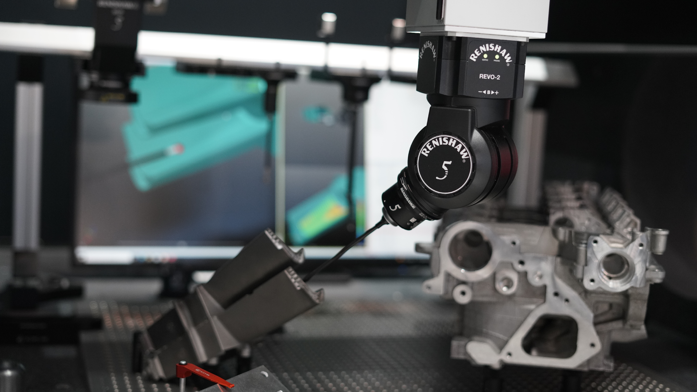

5-axis measurement is an advanced technology that enables a machine to move its measuring tool along 5 simultaneous axes. This method is one of the most effective for inspecting complex parts, with high measurement accuracy and speed.
A measurement method adapted to complex parts and free-form geometries
Measuring on 5 different axes, this technology can measure parts with cavities, angles, inclined and curved surfaces. Areas that are often complicated, if not impossible, to measure with 3-axis technology without having to reposition the part.
The 5-axis head swivels freely, limiting handling and reducing the risk of error, while saving time on overall inspection time. Note: 5-axis technology is renowned for its high scanning speeds – up to 500 mm/second with the Revo-2 head, for example.

On average, it is estimated that 5-axis technology can reduce part measurement cycle times by 25-50%. And that’s without compromising on measurement accuracy, as Renishaw’s slogan ”Speed, Accuracy and Agility” promises.

One of the great advantages of 5-Axis technology is its ability to change probes without having to change the measuring head, and therefore remain on the same machine.
Whether you want to scan in 2D (on X and Y axes), probe on three axes, measure thickness by ultrasound, control without contact or measure the roughness of your part, it’s all possible thanks to the agility and flexibility offered by the Revo-2.
These probe changes, directly on the 5-axis head, keep unnecessary movements to a minimum. You can even, directly on Metrolog X4, display the trajectories of all heads and styli, for maximum understanding and follow-up of your measurement.
