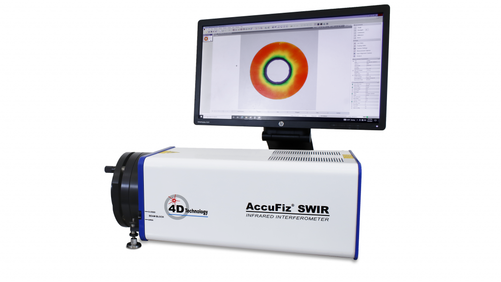

4D Technology, a subsidiary of Onto Innovation, has announced the production release of the new one-megapixel (1 MP), high-resolution AccuFiz Short Wavelength Infrared (SWIR) Fizeau interferometer. This release coincides with the delivery of multiple orders from leading U.S. defense and space-focused companies for the new AccuFiz SWIR interferometer.
The instrument was designed in response to the increasing needs of our customers’ component qualification and optical alignment needs in applications in aerospace, space and satellite communications, and earth-observing in the infrared.
The new AccuFiz SWIR Fizeau Interferometer, operating around the 1550nm wavelength, provides numerous advantages for optical measurements including:
- Industry-leading 1024 x 1024 camera resolution for improved spatial resolution to maintain the integrity of transmitted signals to tight tolerances, resulting in better imaging, less signal loss, and higher efficiencies of SWIR optical systems
- Unique capability to accept external sources at wavelengths throughout the C-Band, enabling manufacturers to test optical components and systems at every operational wavelength between 1535nm – 1565nm
- Temporal and dynamic acquisition modes for fast, vibration and turbulence-immune measurements
- Vibration immunity via dynamic interferometry to measure in challenging environments, without isolation
- Compact, lightweight design that simplifies test setups and use in multiple configurations
- Highly accurate measurement of concave, convex and afocal SWIR optics and systems, aspheres, windows, prisms, corner cubes, and other optics
- Real-time optical system alignment and collimation feedback
