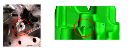

Initial 3D scan taken after a part of a mold broke

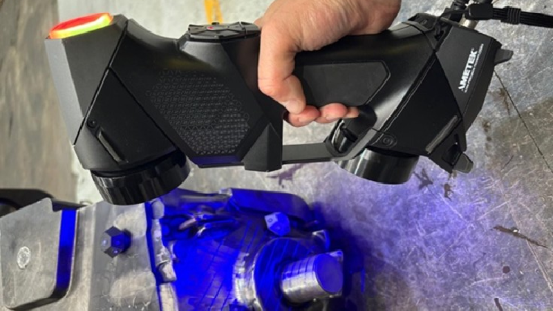

After evaluating different technologies, Nemak selected the HandySCAN BLACK|Series combined with Inspection, the software module for part inspections that is part of the Creaform Metrology Suite, due to the solutions’ speed, flexibility, and accuracy.
“Other options felt rigid,” said Iñigo. “The HandySCAN 3D gave us freedom. Its handling and portability were major game-changers.”
Why Creaform fit Nemak’s needs:
  • Lightweight, truly portable scanner that can be used directly next to the mold
  • High-accuracy scanning, regardless of shop floor conditions
  • Integrated 3D scanning software dedicated to part inspections
  • Short onboarding time: technicians were comfortable 3D scanning within weeks
  • Straightforward integration and intuitive interfaces that required no disruptive process changes
Nemak acquired the 3D scanner in 2022. Implementation was easier than the team anticipated. “Everything went smoother than even our expectations,” Iñigo noted. “Onboarding was much faster than we thought.”

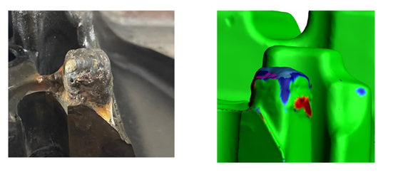

The second 3D scan captured while the repair was in process
With the new workflow, the team began by scanning the damaged sections of the mold directly in the workshop, capturing the complete geometry of the worn areas. Once the scan was loaded into Inspection, the software exposed every deviation from the original CAD model, making it clear where the mold had shifted and by how much.

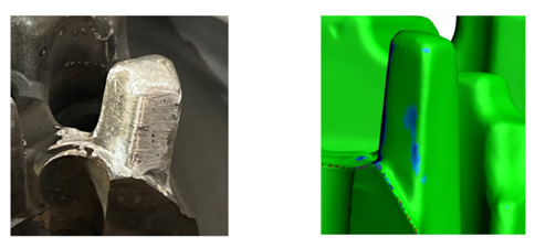

The third 3D scan recorded after completing the repair
That information became the roadmap for the repair. Technicians could approach machining and welding with a clear plan, understanding which surfaces needed attention and which to leave alone.
What used to rely heavily on intuition became a data-driven process. “The accuracy of the scan makes the repair much more predictable. We’re not guessing anymore. We know exactly the work to be carried out.”
