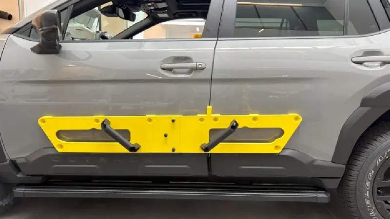

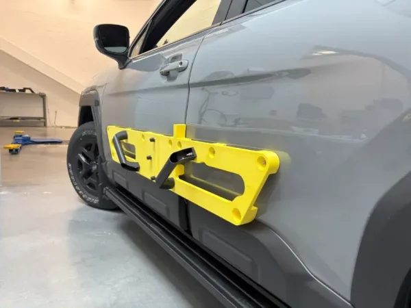

Subaru’s engineering teams, which support the development of accessories and installation tooling, are among the first customers to implement the new T25 High Speed Head. The teams are using the new head to improve speed, consistency, and responsiveness across workflows that are critical to keeping automotive installation lines running smoothly.
As a result, the automaker has achieved:
- A more than 50% reduction in development time for tools
- Overall prototyping and tooling costs reduced by 70%
- A 36-inch tool printed nearly twice as fast (1.96x increase) compared to the standard head offering
With the T25 High Speed Head, Subaru was able to consolidate production onto the Stratasys F770 platform, improving repeatability and part quality while enabling faster turnaround for urgent tooling requests. This approach has helped Subaru respond more effectively to changing requirements while reducing reliance on long lead times and outsourced manufacturing.
