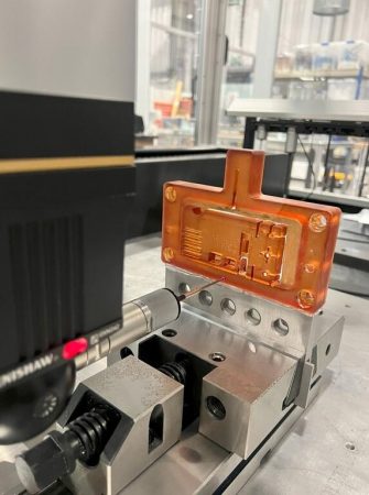

Engineers began with an iterative investigation, researching best practices for minimising distortion in resin 3D printing and measuring the initial reference mould to quantify baseline warping. Process refinements, including a more rigorous cleaning protocol prior to curing, produced immediate improvements in flatness. However, the inherent brittleness of photopolymer resins prompted a strategic shift in direction. The team moved to Selective Laser Sintering (SLS) and selected Nylon 11—a material with much higher elongation—to allow stresses to distribute more uniformly throughout the mould during clamping.

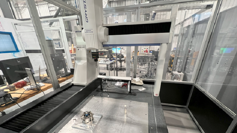

Successive iterations focused on optimising geometry and structural performance. Simplified features, thinner walls, and adjusted flow channels aimed to limit warping while maintaining mechanical resilience. Throughout the development loop, metrology played a crucial role: a Renishaw touch-trigger probe was used to capture detailed coordinate data from internal mould surfaces, verifying alignment to CAD geometry and tracking improvements across iterations.
This structured process ultimately paid off. AMRC Cymru successfully produced a moulded polypropylene part using an SLS-printed mould, demonstrating meaningful progress toward reliable additively manufactured tooling. The findings, however, highlighted the trade-offs inherent in the approach. While the first SLS mould exhibited greater flatness change – around 120% more variation than the resin version—its superior toughness allowed it to better withstand injection moulding clamping forces. Attempts to reduce wall thickness from 7.5 mm to 3 mm helped with warping but introduced structural weakness, leading to mould failure under load. The team also discovered that polypropylene adhered to the SLS mould surface, underlining the need for appropriate release agents, and that simplifying part geometry was essential for consistent results.
