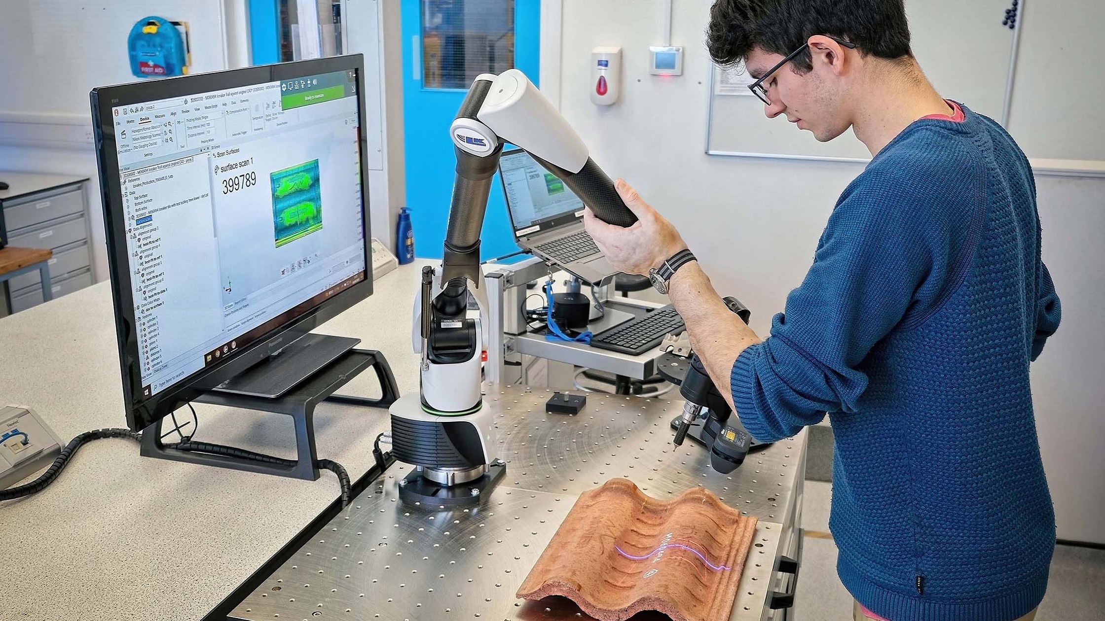

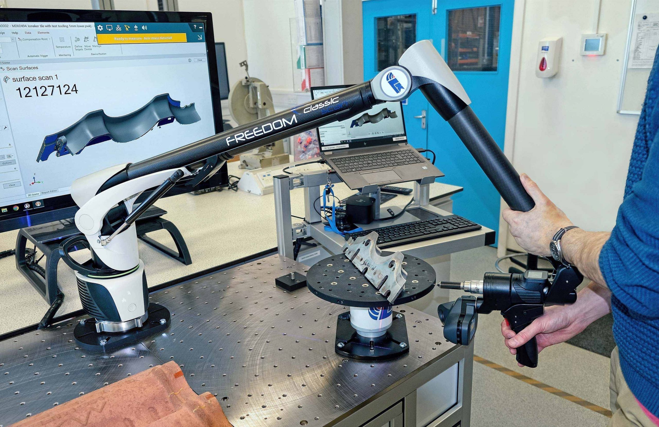

This is the scenario at the Crawley Technical Center of BMI Group, a leading manufacturer of flat and pitched roofing systems, where since July 2024 design engineer Luke Kelly and several of the team have been using a portable measuring arm inspection solution supplied by LK Metrology. Superseding a smaller and now unsupported arm and touch probe, which was used alongside conventional, manually-intensive metrology equipment such as callipers and height gauges, the new inspection technology comprises a 7-axis, multi-sensor FREEDOM Arm Classic Scan with a 2.73-metre reach equipped with a touch probe and an H120 laser line scanner, which since the end of 2023 has been manufactured by LK following its acquisition of Nikon Metrology’s laser scanner hardware and software business. Together with a rotatable, 300 mm diameter FREEDOM Index Table, the lightweight carbon fibre arm is mounted on a metrology table, all elements supplied by LK. Additionally, Innovmetric’s PolyWorks Inspector software was purchased to provide advanced point cloud analysis, evaluate surfaces, measure geometrical features, generate coloured heat maps for part-to-CAD or scan-to-scan comparisons, and generate full reports.

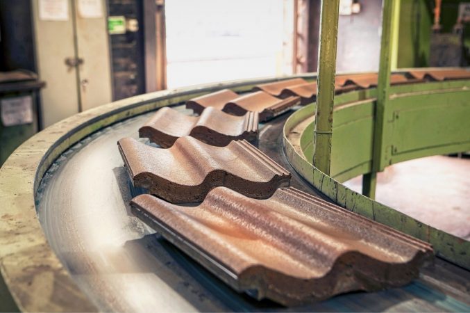

One of the most important inspections performed is on the die-cast aluminium moulds used to form the underside of concrete tiles in the extrusion process. The pallets are subject to abrasion and erosion and there are tens of thousands of them in a set, according to the size of the tile manufacturing operation. Re-equipping a large factory with these pallets can cost well in excess of ÂŁ1 million, so it is important to take samples regularly to assess their condition, predict lifespan and identify production line issues. This process is now significantly streamlined with the new LK system, which is especially useful as the frequency with which pallets are sent to the Technical Center for analysis has increased in recent years. The scale of the task is amplified by there being hundreds of pallet sets across the group, including for main tiles, cloak verges, ridges and special fittings.

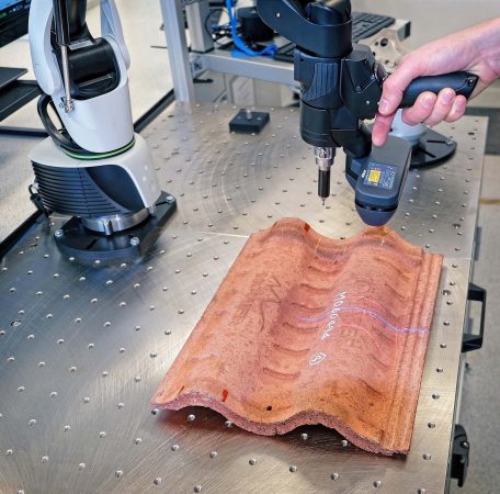

“Reverse engineering of tiles using the scanner is much faster and richer in detail than our previous method of taking individual cross sections. For some applications where we want a reference CAD model, it will save us days of work creating it from scratch, as we can simply use the STL output from the laser scanning software.
“The touch probe is mainly needed on the end of the LK arm for checking, both to the design and to EN 1024 standards, the twist and camber of clay tiles after they have been fired in a kiln. Inspecting the requisite 10 clay tiles each time would take too long to complete by laser scanning.”

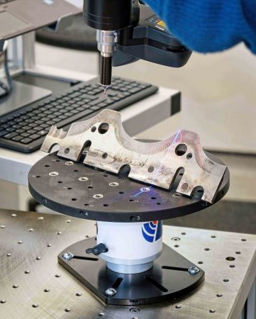

The range of component sizes in Crawley is vast, from 0.5 mm thick sheet metal through small plastic and metal clips to a solar roof panel measuring more than one metre across. The LK metrology solution copes with all of them and enables much more comprehensive reporting than previously. Luke said that scan times are quick and the reporting tools are easy to use, rapidly producing easy-to-understand images for further analysis by specialists. The index table is useful for accelerating the measurement of some smaller parts where all-round access is required. It is another reason for having the end-of-arm probe, which is touched into three or more fiducial dimples machined into the top of the table and around its periphery. It is then a simple matter to click the on-screen FREEDOM Index Table macro in the PolyWorks software to update the coordinate system and continue capturing the surface data.
